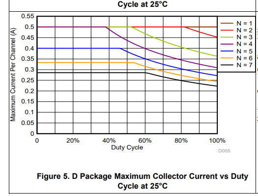

  • Hi Neet,
    1. Yes, but the driving strength will be reduced and thus the RON/VOH will be increased.
    2. No, this device needs the COM pin powered to drive the FETs. For a device that doesn't need a voltage source on COM, please see ULN2003A.
    3. Please see the attached Figure 5, the maximum rated value in the data sheet is 600mA (channels can be paralleled to increase current capability), but this could be higher if the ambient temperature is low.
    4. No additional measures, the internal flyback diodes are rated for 500mA so please make sure the current through them won't exceed that.
    Patrick
