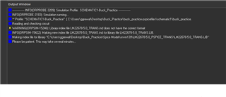

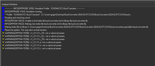

I am trying to simulate LM22678TJE-5.0/NOPB in my buck converter design using PSpice For TI, however, I am running into the following warning and the simulation just stops. This warning seems to be related to the inductor.
Warning: "ORPSIM-15256" (See screenshot below)
I checked the spice model for the inductor and noticed that the values for the six parameters in the warning ("a","Is","L","Z0","F0","EL") is just 0. Is this something I have to talk to the manufacturer (CoilCraft) about or I can do something else in PSpice myself in order to go past this warning issue so that I can get my simulation working? (For example, can I just delete these 6 parameters from the spice model file since I doubt they have any affect?)

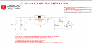

  • For the inductor in the schematic, I am using model library from CoilCraft (downloaded from their website)
  • I have attached archived zip file of my project for reference.
