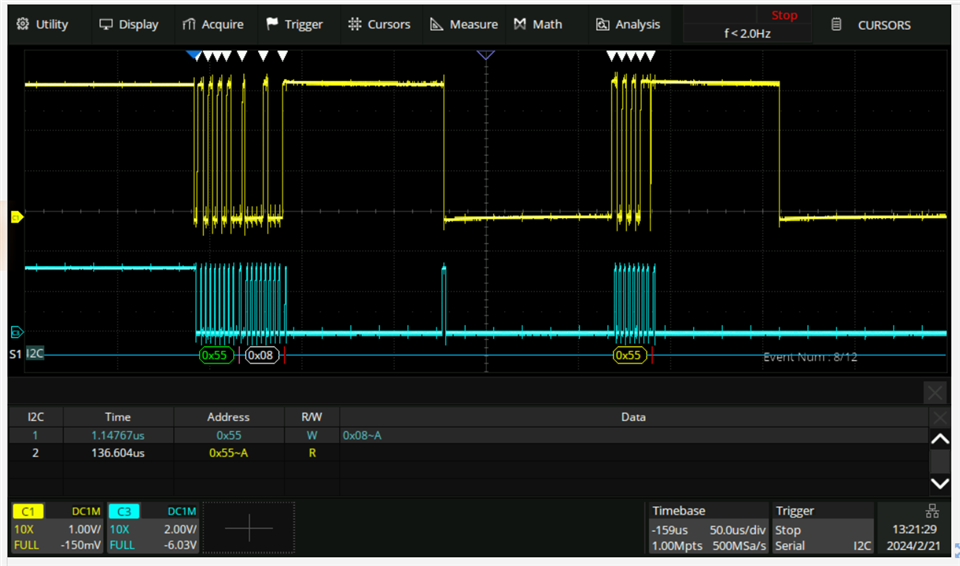

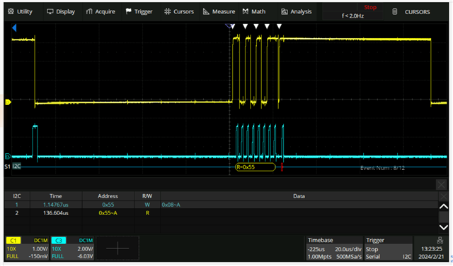

Below are some screen shots from the oscilloscope.

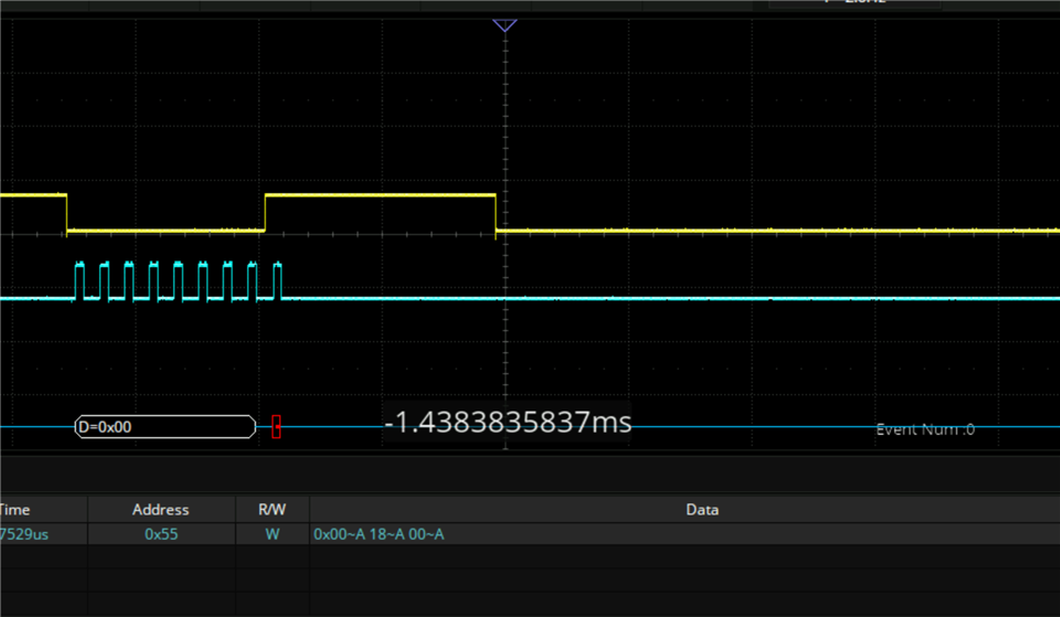

An example trying to write to the dataFlashClass register 0x3E. Yellow is data line, blue is clock line.
Chip acknowledges the address 0x55
After the acknowledge of 0x55, trying to write 0x00 to the chip, the chip do not acknowledge and pulls down the data line
  • For some reason, the comments on the pictures disappeared.
    Yellow: SDA
    Blue: SCK
    Image 1: Showing how the chip pulls down the SDA line after acknowleding 0x55, but not acknowleding register 0x3E.
    Image 2: Detail view of acknowleding 0x55
    Image 3: Detail view of not acknowledging register 0x00 and pulling down the SDA line:

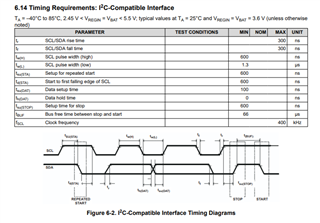

    After consolidating my team, we believe your issue is related to timing, try to match to match the timing diagram from the datasheet.
    BQ34Z100-G1 Wide Range Fuel Gauge with Impedance TrackTm Technology datasheet (Rev. D) (ti.com)

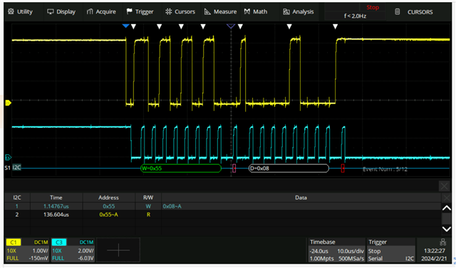

    Here is a o-scope shot I took of the BQ34z100 reading 0x08 from address 0xAA, please try and match the timing.
    SDA on top
    SCL on bottom

  • Hi Evan, thank you for your advice on timing.
    I have tried connecting an Arduino to the I2C bus on the pcb to figure out if the issue was timing/capacitance in the bus lines. The Arduino is connected to the i2c lines right next to the ftdi, so the length of the bus lines should be roughly the same.
    Using the Arduino, I am indeed able to read data from registers on the chip. But I've not been able to figure out what key differences in the i2c bus setup that enables me to read using the Arduino but not using the ftdi. Both the Arduino and the ftdi are set up with i2c frequency of 400KHz.
    Below are some o-scope snapshots from both the arduino and the ftdi.
    Any thoughts and tips for a way forward to solve the issue of reading the BQ34Z100-PWR chip using the Ftdi is greatly appreciated.

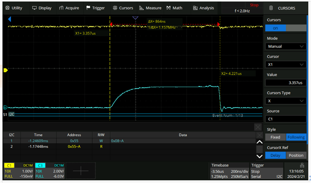

    Read of register 0x08 on the BQ34Z100-PWR (address 0x55). As you see, I'm able to read out data from the register.

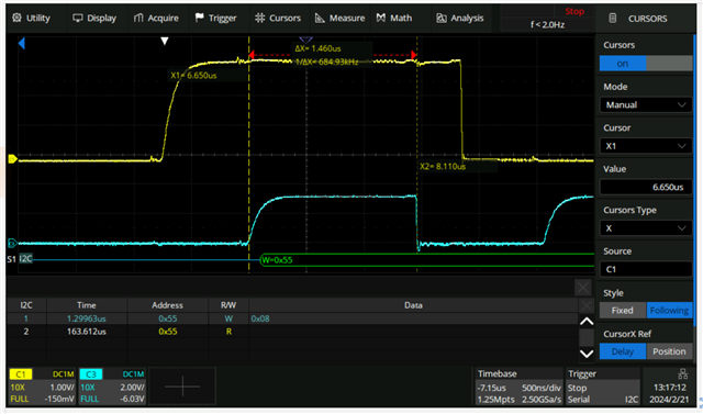

    Same read attempt using the ftdi. As you see, the chip does not acknowledge the 0x08 register, and does not acknowledge on address 0x55 on the read command.

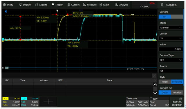

    I have tried to compare the SCL/SDA rise times, but they are both under 300ns.
    Risetime of SDA on arduino.
    Risetime of SDA on ftdi.
    I have noticed that the clock width are a bit different, but both are within the timing criteria of minimum 600ns.
    Clock width arduino
    Clock width ftdi.
    For some more data, I have provided below close ups from both the arduino and from the ftdi:
    Arduino:
    Ftdi:
