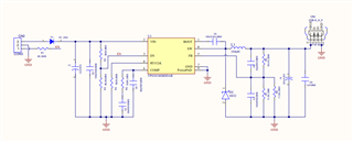

I have designed a buck converter using TPS54340 where the specifications are given below
Vin= 22V-30V
Vout = 5V
Iout= 2A
Switching Frequency=100kHz
L=100uH
Cout=220uf

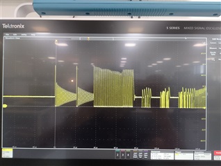

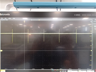

the problem is that i am not getting any switching pulses (PWM is not working) although the output voltage at no-load is 5V but as soon as i connect a load it drops to some mili-volts.
Fig-1 is Switching waveform(SW to Gnd)
Fig-2 indicates the voltage between pin VIN and SW
