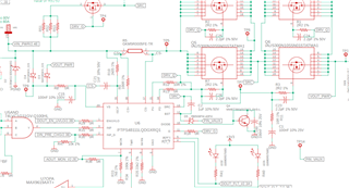

TPS4811-Q1: Device turns on power fet's on with all logic inputs low
Part Number: TPS4811-Q1
I am bringing up a new board using this TPS48111-Q1 however I faced an issue right away: The device enables the MOSFETS with the EN pin low, IN Pin low and precharge pin low.
Have you seen such behavior? Attached is a snippet for the relevant schematic
Edit: After further investigation I notice two strange measurements: again with the part turned off the voltage at Vs pin of the TPS48111-Q1 is higher than the input voltage into the board which really baffles me. Also Teh BST Voltage scales directly with the input voltage
