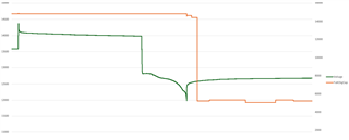

We're using a LiFePO4 battery and are using the BQ34Z100 on a separate pcb to monitor just the voltage, current and state of charge/capacity. We've managed to complete the learning cycle and are running some tests to verify the gauge's behaviour.
In this particular test the battery was charged to full, allowed to relax for about 20 hours, discharged, and left to relax.
Do you know what could cause the Full Charge Capacity to radically drop when the battery is relaxing at a low voltage?
I've attached the full recorded log.
02-01 odd capacity drop.zip
    Did you use the GPCCHEM tool to get a chemID match with DOD% error of 3% or less?
    You said you completed a learning cycle, can you verify learned status is 0x06.

  • It looks like we were indeed using the wrong chem id and got this far with it. I've attached the report from the tool. The tool recommends a different one with 12.6% error. I'll run the chem id check again to confirm the results and test how this performs.
    What sort of performance issues do you foresee if the error is not under 3% as you recommended, or is that classified information regarding your algorithm and gauge?

    What is the chemistry of your battery?
    Can you share the data you used to create this report, or if you are going to redo the discharge cycle, please share the new data.
    This document may be useful - Simple Guide to Chemical ID Selection Tool (GPC) (Rev. A)
    Evan
  • If you use a ChemID with this much error, it could lead to SOC errors and SOC jumps.
    Evan
  • The battery consists of unidentified LiFePO4 3.2V 4.2Ah cells.

    In the second data set, I tried to discharge the battery closer to the 10V/2.5V per cell limit. This apparently dropped the previous id suggestion 475 from the recommendation or it was dropped due to other variations. We assume that the lower voltage limit for these cells is 2.5V but we can't reach it exactly since at that point the battery's own protection will cut the power and disrupt the data.
    I had previously overlooked that you said that you are using an LiFePO4 battery. These batteries have a long and flat ocv curve and are difficult to match perfectly.
    I recommend proceeding with the 12.6% error ChemID and enabling LFPRelax bit.

  • The 0475 chemistry with 12.6% error didn't end up working. During the discharge cycle, the RUP_DIS flag was set when it was updating the ra table. Should I try the 0400 chem id that had 14.5% and 13.9% errors? Or does the error mean that it will also automatically fail?
    I've attached the full logs from bqstudio. They ended up being in two parts since the tool was needed briefly elsewhere.
    02-26 failed discharge cycle bqstudio logs.zip
    Your learned status is 0x05?
    how long did the battery rest for after discharging?
    Is this the chemID you had previously completed a successful learning cycle with?
    Evan
  • -Your learned status is 0x05?
    I did not reset that register. It's still 0x06 from before. Before the calibration attempt, I ran the RESET command from bqstudio which cleared at least the ra table values.
    -how long did the battery rest for after discharging?
    The battery was:
    -Is this the chemID you had previously completed a successful learning cycle with?
    No. I was trying to run the calibration for the new chem id 0475 that you recommended to try based on the GPCCHEM tool's report:
    And yes, the LFPRelax bit in Pack Configuration B is enabled.
    So your guess is that the gauge didn't actually achieve a proper 0x05 learned status and that's why the ra update indicated an incorrect chem id? Does achieving the 0x05 learned status depend on the selected chem id and how does the LFPRelax bit change that part of the calibration?
    Thanks for answering my questions with details.
    Appears to me that the process was preformed correctly, you're going to need to send us some cells to create a custom ChemID for you, since we don't have a good match for your battery. This will give you a ChemID that does not raise the RUP_DIS flag and will have very low DOD% error. You can reach out to your local TI office or your supporting FAE for help with this. If you have any problems with the process, please reach out to me and we can discuss in private messages.
