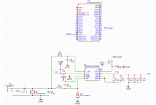

  • Hi Hailee,
    We have now switched to shunt fet dimming. The current schematic looks like this:
    We plan to use these LEDshttps://download.luminus.com/datasheets/Luminus_SST-20-WxH_Datasheet.pdf
    Input voltage range: 42V
    Output voltage: approx. 36V (We now use 12 LEDs here)
    Iled: 0.1 to 1.5A (variable via PWM)
    fsw: 128kHz
    Does that look right to you? Do you have any tips for us on what we should do differently?
    Thank you for your support!

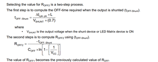

  • Hi Daniel,
    If you'd like to use a shunt FET dimming, please refer to the below picture for COFF connection and 8.3.4 OFF-Timer, Shunt FET Dimming or Shunted Output Condition in the datasheet.
    I think your schematic follow the EVM design, what are your PWM_IADJ signal and PWM signal? I just want to check your current range and shunt PWM duty cycle. and you can use this tool to calculate the spec that you design - like current ripple, fsw -   SLUC613 Calculation tool | TI.com.

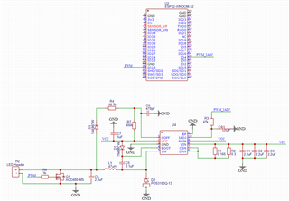

  • Hey Hailee,
    Thank you very much for your support. We have now adapted the schematic as follows:
    We are not sure how to calculate R OFF1 and R OFF2 and are also not quite able to cope with the Excel table. The ESP32 produces a 128kHz 8bit signal for PWM_IADJ and PWM. Can you tell us which resistor values are best suited and whether the rest of the circuit is also ideal for our project in your eyes?
    Thank you so much!
    Daniel
  • Hi Daniel,
    The parameters depend on your design requirement, like inductor current ripple, input voltage range, output voltage, Viadj....
    You can directly input these requirements in the calculation tool, and post it in this thread, I can help you review it.
    These equations can be used to calculate the Roff2, and the value of ROFF1 becomes the previously calculated value of ROFF.
    General speaking, if you follow our EVM design, I think it can work, but please ensure your design specs.
    Thanks! Hailee.

  • Hi Daniel,
    Generally, n can be 0.90 or so, it is affected by many factors; Iled-pk-pk is the LED current ripple, Il-pk-pk is the inductor current ripple - depends on the desired fsw, the L size, efficiency... also it is a balance between these factors. In the application design of the datasheet, Iled-pk-pk is 10%, and Il-pk-pk is 45%. you can change it according to your application.
    For UVLO function, it is a protection for input voltage, if your Vin is very fast, this function may be not necessary, but if your Vin is not fast, it needs to be considered, these values should be above the LED minimum voltage you would want to set it at ideally, and below the min input voltage, then the hysteresis is sort of dependent upon the application, but you can still set it in this range.
    Vshunt is the output voltage when the shunt device or LED Matrix device is ON. For example, Rdson of shunt FET is 0.05ohm, ILED=1.5A, then, Vshunt = 0.05 x 1.5 = 0.075V.
