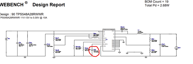

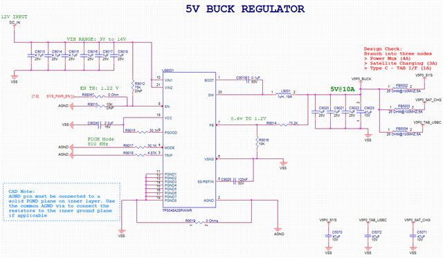

Hi TI Team,
We plan to use the TPS548A28RWWR regulator in our new design and did a simulation for the same using TI webench.
In the simulation a 120nF cap is connected from SS/REFIN pin to AGND, but in the datasheet is not recommended to connect a cap between SS/REFIN and the AGND pin.
Kindly let us know which to follow...
