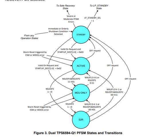

We want to reset individual core (R5F, A72) of TI TDA4VM USING EXTERNAL WATCHDOG (PMIC TPS6594-Q1). PLEASE give step by step process and configuration

firstly can you give me your part number for the TPS6594?
For example TPS6594XXXX, where the XXXX denote some alphanumeric combination.
The watchdog reset is highly dependent on the setup and hardware, so are you using the watchdog in Trigger or Q&A mode?

part number is as follows; PTPS659413F0RWERQ1
we have not configure to Q&A mode.
what are advanatge / ease of using trigger or QA mode .

Please be aware that this part is no longer offered as there have been upgrades in Silicon, this part is also used in a dual setup.
The current replacement parts are TPS65941213-Q1 and TPS65941111-Q1 for the DRA829 or TDA4VM.

Depending on what state you're in, a warm reset from the WatchDog is possible.
The Watchdog is already enabled, and if you want to cause a warm reset to toggle the PoR pins for the respective domains, either incorrectly answer, answer in the wrong sequence, or let the long window elapse.
As described in section 8.3.11 Watchdog (WDOG) in the datasheet for the TPS6594 (click here for TPS6594 Datasheet)
