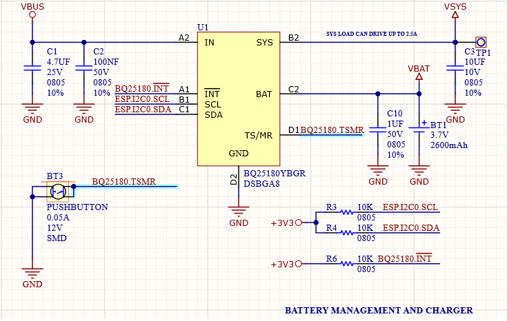

I had follow the tips of related previsious question (e2e.ti.com/.../bq25180-bq25180-not-exit-shipmode-with-button-press and i remove the diodes to push TSMR pin direct to ground when push-button is pressed.
Now, the circuit is according the following screenshot:
This is my current initialization function:

I reading the TSMR pin state with this function:
bool BQ25180_GetTSMR(void) {
    BQ25180_Register_STAT0 registerSTAT0;
    BQ25180_ReadRegister(BQ25180_REGISTER_STAT0, (uint8_t *)&registerSTAT0, sizeof(registerSTAT0));
    ESP_LOGW(TAG, "TSMR Status %d", !registerSTAT0.TS_OPEN_STAT);
    return !registerSTAT0.TS_OPEN_STAT;
The expected behavior is when pressed the function return 1 (true).
I read the state of TSMR when VBUS is connected and have worked fine as expected (return 0 when not pressed the button and 1 when pressed), but when powered just by battery the state of TSMR is always return 1.
Why the  reason for this behavior?

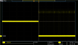

    Can you please clarify how the state of the TSMR is read? Is an MCU pin connected to TSMR as to read the voltage level of the pin?
    If so the possible explanation may be related to how TS/MR behavior differs in Charge mode vs Battery only mode. When VIN is present the pin is constantly biased to monitor the TS voltage so the voltage is typically high there. While in BAT only mode the TSMR is only biased in pulses in order to minimize current consumption, these pulses are used to determine when MR is pressed. This means the average voltage is very low so sampling it will most likely indicate a low voltage on the pin at this time.
    Below shows the difference between VIN present (charge mode) and battery only mode for BAT.

  • Are possibel put a pull-up from vsys to bias the TSMR?. I read this signal using a GPIO.
  • What's the suggestion to read the TSMR pin state when powered from battery?
  • A pull up to SYS may help in raising the average voltage, but I would keep in mind that it's likely to increase current consumption while in BAT mode and charger mode. Additionally, it will definitely have an effect on TS behavior while charging, based on your schematic I'm assuming its not being used so I'd recommend disabling it via I2C.

  • I do a mistake. I reading the signal using a I2C bus by STAT0 register (TS OPEN).
    I will try use the pull-up to solve thi question.
