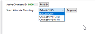

    Did you follow section 3.2 for Procedure to Select Alternate Chemistry? Make sure you are using correct battery chemistry profile.
    If you are not sure about the battery chemistry you are using, please use our GPCCHEM tool to find if your battery is well matched to one of the three supported chemistries.
    These are the chemistries this gauge support. The result from the GPCCHEM tool will tell you if it matches to one of these three.

    We are using linux platform hence we unable to use BQStudio and GPCCHEM tool.
    I tried using alternate chemistry but still seeing random jump of SOC.

    Choosing alternate chemistries will not fix the SOC jump. This is voltage correlation gauge, meaning that if the cell chemistry OCV table differs from the programmed ChemID OCV lookup table, the SOC will be inaccurate.
    I suggest to use the GPCCHEM tool, this one will report if your battery chemistry is close enough to ChemID 1202 which is 4.2V based.
    Also, do you have the smooth enable feature ON? I would disable RCJUMPOK and enable SMTHEN
