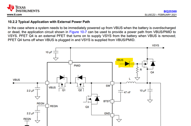

 I'm designing a board with BQ25300 in power path configuration. I'm not sure what's function of diode that connect VBUS to Q4.G.
Is it used to compensate for the drop on Q1? Wouldn't it be better to connect VBUS directly to the Q4 gate?
In any case, I'm fine with putting it but I'm undecided between a Schottky (e.g. PMEG3010EH) or a silicon (e.g. 1N4148).
Thanks for any suggestions
