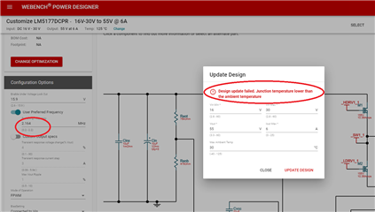

Hi, I would like to use LM5176 to drive a GAN switcher @ ~600KHz.
I have read a reply regarding the same inquiry:
"You can supply an external fixed 5V to VCC by disconnecting the VIN from input line but connecting to VCC. However, your boost strap voltage may also need to be clamped not to exceeding 6V, then you may be okay to drive GaN.
Not sure what GaN do you plan to use.  Just note that your GaN may not have a body diode.  So you may also need to add external Schottky to allow the inductor current flow during dead time.
So in that case, Vin will be left unconnected? Do you have any example schematic? Also there are many ways to limit the boost strap voltage, any recommended type?
