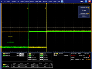

Please find below the oscilloscope capture of WDOG_DISABLE and nRSTOUT (MCU_PORz) during power on. There is roughly 20 mS of time duration of WDOG_DISABLE set high before nRSTOUT goes high. This fulfills the 30 uS requirement of tWD_DIS (DISABLE_WDOG input signal deglitch time).

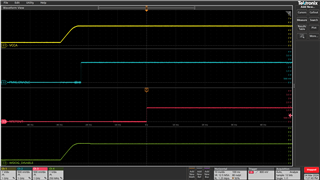

  • Hello Nicholas,
    as suggested we pulled-up WD_DISABLE (GPIO8) to VCCA with a 10 kOhm resistor:
    It seems like this made no change to the PMIC registers:

  • Götz,
    I have been trying to recreate your issue on EVM, with 5V input and the separate power supplies for the proper boot sequence.
    The watchdog power holds works as expected and have not been able to recreate this issue. I know this may seem silly, but where on the board are you probing?
    In the schematic and I can't see the network, so please double check this probe.
    The logic is hard tied to the device that input voltage raising with VCCA to 5V should be enough as the threshold to turn on all internal logic ~2V75 and the threshold for logic high on GPIO8 being ~1V26.
    BR,
    Nicholas

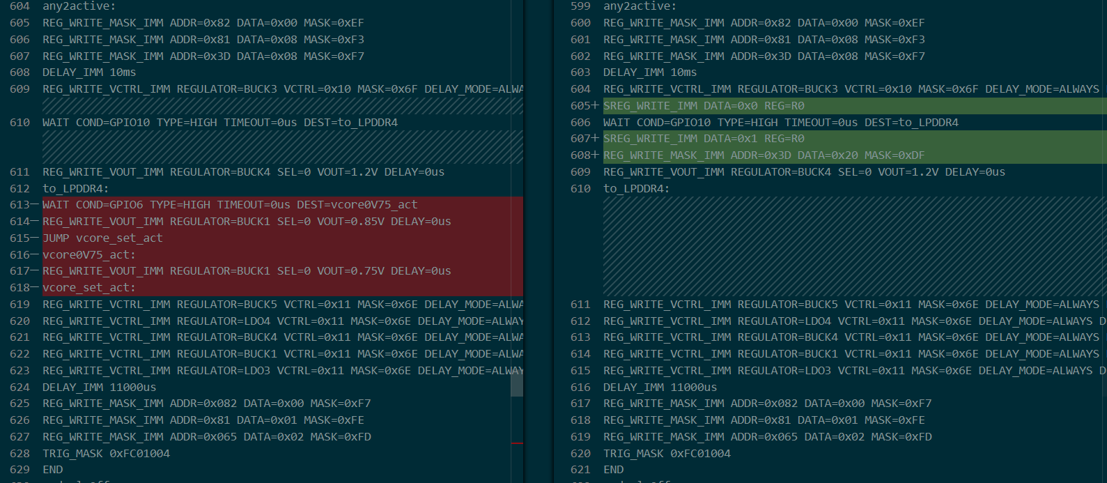

    One difference I noticed between the PMIC on the EVM and the PMIC on our custom board is the register value TI_NVM_REV. On the EVM, TI_NVM_REV is 2, on our board TI_NVM_REV is 5.
    What are the differences between these revisions?
    Pascal
  • Hello Pascal,
    The biggest difference is highlighted below, and it has to do with the GPIO6 input for switching voltage on the core.
    On the left is the rev5, rev3 on the right.
    Nothing about GPIO8 or the watchdog is changed between any of the versions.
