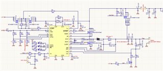

I would like to use the BQ24618 as a charging circuit for a 6V 7AH lead-acid battery. Requirement 800mA charging current. 1.46A system current. End of charge voltage 6.9V. Input voltage 12V.
As soon as I connect a battery, the IC seems to detect a short circuit and does not charge.
When I disconnect the battery I still get 800mV at the battery output. I only get rid of this when I remove the input voltage and reconnect it. Without Bat at the output I get the 6.9V.
  • Hello Marcel,
    I'm going to review your schematic, and will give you an update by Friday.
    Christian.

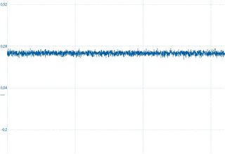

    Now I have measured the voltage at the feedback.
    I have replaced the BQ24618 with the BQ24610. Unfortunately with the same result.
    Feedback Pin 12 without battery.
    feedback Pin 12 with Battery (6,36V)
    feedback Pin 12 after removing the battery. (0,796V on Battery output)
    I have the same behavior when I cause a short circuit on the battery connection. Could it be that a minimum charging current is required? Is 800 mA too little as a charging current?
  • Hello Christian. I have solved the problem. The temperature input was not soldered correctly. Now the circuit works. Many thanks for your help.
