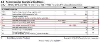

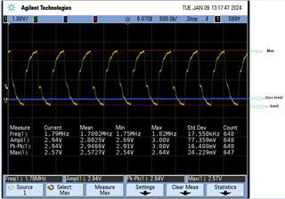

Hi BU,
If the host controller and TLC5971 are on different PCB board and then we measured the SPI waveform as below.
May I know which low level to be used as VIH/VIL base level in the SCLK waveform below?
