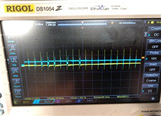

I have a design that is using the LM5116 for both 5V and 12V buck converters. I have seen some failures with the 12V circuit but not on the 5V circuit when there is sparking (e.g. after connecting to a battery directly). I decided to look at the oscilloscope of the low side mosfet VDS and see that the voltage is crazy sometimes upon startup for a brief period of time. Thereafter, it does not have these spikes. The 5V circuits never seem to have this behavior. Do you have any ideas about what differences in the schematic may be causing this abnormal activity on 12V vs 5V?

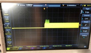

This first scope shot is zoomed out and showing the nasty peaks that exist for about 50 ms upon startup. Thereafter it goes away.
This second scope shot is zoomed in and looking at the VDS signal of the low side (yellow) and the VDS signal of the high side (blue) during that startup sequence.

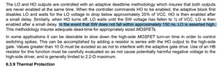

    I think you are seeing the forced LO turn-on which can happen during soft-start.
    Please try lower gate charge & lower parasitic capacitance MOSFETs and check if any improvement.
