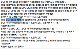

Hello I am trying to communicate with the BQ79616EVM it requires:
  • Baud rate = 1 Mbps
  • UART RX baud rate error - requirement on the external host : -1% => 1%
I am using Micro-controller LAUNCHXL-F280039C with SYSCLK = 120MHz and LSPCLK = 30MHz.
The problem is I can not generate a baud rate within the required range from the BMS chip.
This is the equation:
