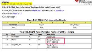

I get wrong part number when i ask the TI GUI, I don't know if it's a glitch on GUI or new unsupported chip behavior:
This is the datasheet relevant section
The value should be 0b011 for BQ25798 and we get 0b111.
this happens with every chip i tested so far, weather on EVM or our PCB
Any clue?
Many thanks in advance.
