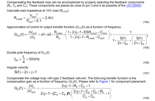

    Please help me to how to set and read the slop compensation equation.
    In equation 107. mention the S(f) formula, so please help me to which value I consider for j. and f for switching frequency is it correct?.
    Sudhir
    j is the square root of negative 1.  When it comes to S(f) this is referred to as angular velocity and is a function of frequency.  Gc(f) is the control to output transfer function.  The gain will move with frequency.
    When it comes to setting up compensation you just need to use the cross over frequency for your design.  If you are using opto feedback this should be 1 to 2 kHz.
