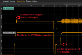

  • I did test this myself on our prototype. A PD contract was implemented, 3V3-VIN power was removed. It does seem like the TPS module enters some kind of reset:
    This reset only seems to occur once however. If I power cycle the 3V3-VIN power supply again, the reset does not re-occur. Is this because this device is now in 'dead battery' mode, and I need to clear the dead battery flag?
    Also, does this reset result in the TPS module re-implementing its boot sequence?
    Jesse
  • You're right - We don't trigger the reset if the device is in dead-battery. Yes, this reset results in the device restarting the boot sequence.

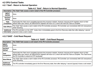

  • Thanks Praneet. Just a heads up I did in fact find a 'reset' 4CC command - 'GAID'. This clears SRAM and implements a reset on the TPS controller:
    However this command is not defined in and TPS25750 or TPS25751 documentation. Is there any kind of document available that completely documents all possible 4CC commands to this controller?
    Jesse
  • What I said before was actually incorrect, this 'GAID' and 'gaid' command are defined in the TPS25751 technical manual:
  • You're right - GAID is available on some variants of the device to cold-start the PD controller, but I didn't suggest that as its not exposed on all devices and the behavior on such devices is undefined.
