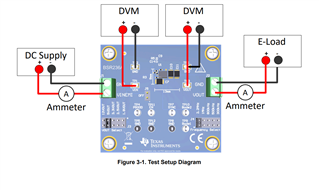

I tried to modify this eval board to get 15V but i'm seeing about 12-13V. Should part should be capable of putting out 15v right ?
Input is 24V.

What is your load current? and where is your test point?
We suggest testing Vout as below shown.

Did you use the test point for testing Vout?
Can you promise the welding of FB resistor is good?
Can you provide Vin, SW and Vout to us for further check?
