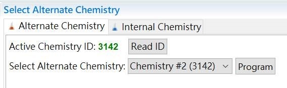

            I'm using BQ27427EVM to check relvant function.

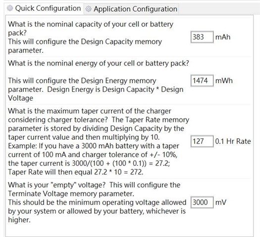

And first I apply our exiting battery and related parameter is set via bqstudio as below.
After charging cycle and found the FullChgCap is 357mAh (383 Qmax) as StateOfChg=100, but actual capacity is over this value (~387mAh) of this battery is confirmed by our battery tester.
Could you let me know if this is reasonable?  Or which setting I need to modify?
In addition, some behavior of gauge during charging I obseved as below,
1. Sample 1625: the “True Remcapacity” is decreased to 273mAH from 308mAh at 85% SOC
2. Sample 2150: the “True Remcapacity” is increased to 79mAH from 28mAh at 10% SOC
3. Sample 2340: the “True Remcapacity” is suddenly changed to 339mAh and SOC update is abnormal (0% to 100%). Not sure if this is due to the voltage not reaching 3.0V (terminal) at this point.
As posted above, Is it related to usable capacity is misestimated by gauge?
Here I also upload the detailed log file for your reference. Please help me on it. Thanks.
