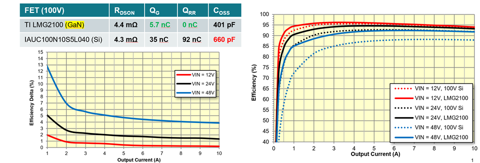

Hello Jimmy,
the LMG design is will provide you with a slight benefit, but thermals will still need to be managed.
I did a search and found these results, I hope this helps.
David.
