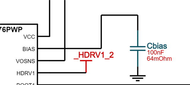

I've been testing our board with the LM5176 designed for the following parameters:
Vin: 19 to 30V
Vout: 25V/ 1A(cont.) and 5A(peak)
During testing (Vin:24.9V and NO LOAD) i observed the following:
The board maintained good regulation during the initial moment when supply is connected and draws about 40-60mA (IC temp: 35deg.C @ ambient of 31deg.C)from the supply. But after a few minutes of keeping the board untouched in the same condition, the IC starts drawing about 110mA from the supply and heats to about 50deg.C (@ ambient of 31deg.C)  and loses regulation at the output. When the supply is disconnected and reconnected after a minute or 2, the IC restarts under the said normal conditions, but again starts drawing about 110mA after a few minutes of keeping the supply connected. I checked the VCC pin and noticed that initially when the draw is at 40-60mA, then the VCC is at 7.13V and when the draw increases to 110mA, the VCC falls down and jumps from 3.6V to 5.8V.
Im not able to understand why this is happening. Please do look into this and let me know what are the possible problems that i may be facing and what can be a solution for this.
I can share the Schematic and Gerber files on private chat for review if that would be necessary.
Thanks and Regards
Noel Binny Abraham

  • Hi Noel,
    can you please replace the Boot Capacitors with a value of < = (Vcc Cap / 10)  e.g. 220nF or 100nF.
    Connect BIAS to VIN, VOUT or to GND (if not used)  -   will not fix this issue but would be better then have it floating.
     Stefan -
  • Hi Stefan
    I will change these Caps to 100nF ones and will update you.
    Ya ok. I used the Webench circuit here and added the 100nF (C15) Cap. I can short this pad. Again, will update you once i do this.
    Is there any possibilty that my IC is damaged? Since it is drawing so much current at NO-LOAD and the VCC voltage is dropping so much? But again, if this is true and my IC is damaged, im trying to understand the reason behind this as i do not want this to keep happening. Any suggestions on how i can understand the issues?

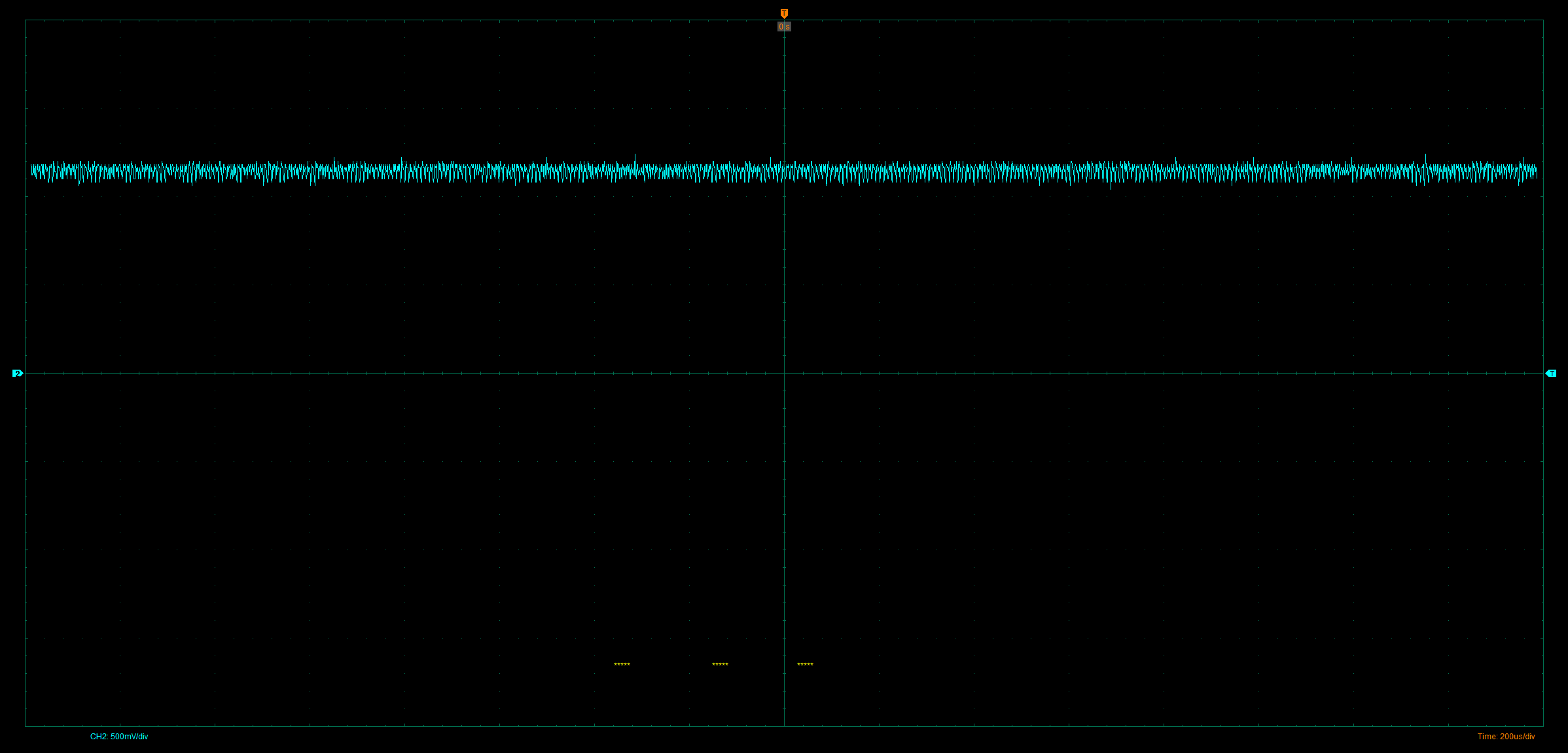

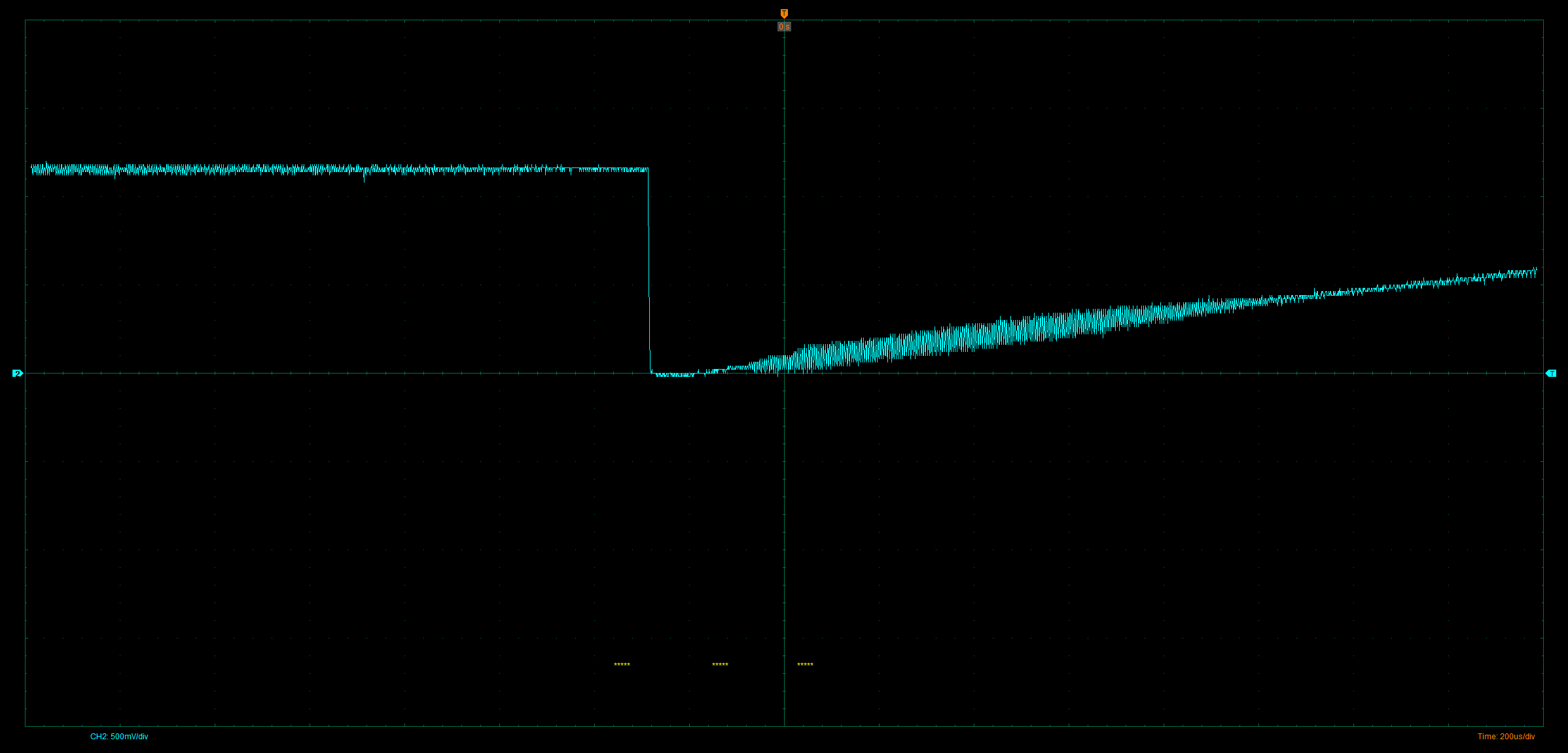

    Can you check the SS pin in this operation mode?
    As for the SS pin during boost mode for higher currents, At a Vin of 20V and 4A this is what i observed:
    And during normal operation (Buck mode, Vin= 27.7V and 2A output load), this is what i observed:
    Im using a 150W supply during this test.
  • HI Noel,
    can you check the voltage signal on the Current sense resistor at CS / CSG,
    Note: you need a very short probe connection - tip and Barrel method -see:
    Common Mistakes in DC/DC Converters and How to Fix ...
    -> shows Tip&Barrell - page 28
    Check if the peak voltage level is below the limit for the over current.
     Stefan
