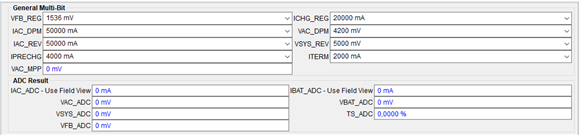

The default registers settings (@POR) are:
so, my doubt is if something happens (like noise, mcu crash, wdg, ecc..) which causes the BQ25750 to restart, there is a risk to damage the entire system.
Of course I can handle the threshold with hardware settings, but if I want to change for example the charge current (via I2C) over the hw threshold, this is not possible.

  • Hello Paolo,
    Thanks for being patient with this. Monday was TI holiday.
    1. You can use I2C to set EN_ICHG_PIN=0. This will allow you to set a higher charge current than the hardware threshold.
    2. I haven't seen this before. What BMS are you using?
    3. This is not possible.
    4. In this case, the BQ25756 has charge enabled and is charging the output capacitors. The output voltage quickly reaches the battery charge voltage and the current reaches current termination. The capacitor voltage then falls to the recharge threshold and the BQ25756 starts charging again. You can disable this behavior by disabling termination (EN_TERM=0).
