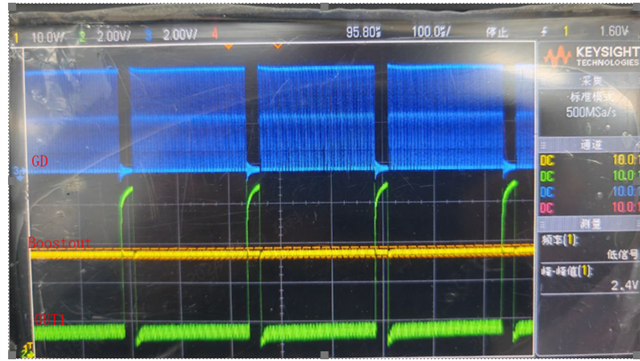

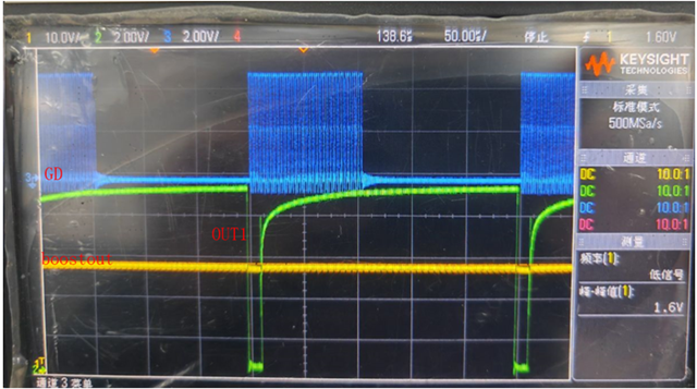

We tested the OUT1 and bootout/GD waveforms as follows: When the backlight is 5%, the OUT1 and GD waveforms do not match
1. Waveform at 95% brightest backlight:
2. Waveform when backlight is 5% darkest:

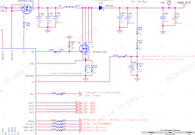

Additional schematic section
HI, Tony
Could you pls explain the doesn't match? Which point you think is abnormal?
Hi, Tony
Because from my side the waveform is normal for 95% and 5%, so I need to ask what is the concern from your side and maybe I can give you an explaination.
