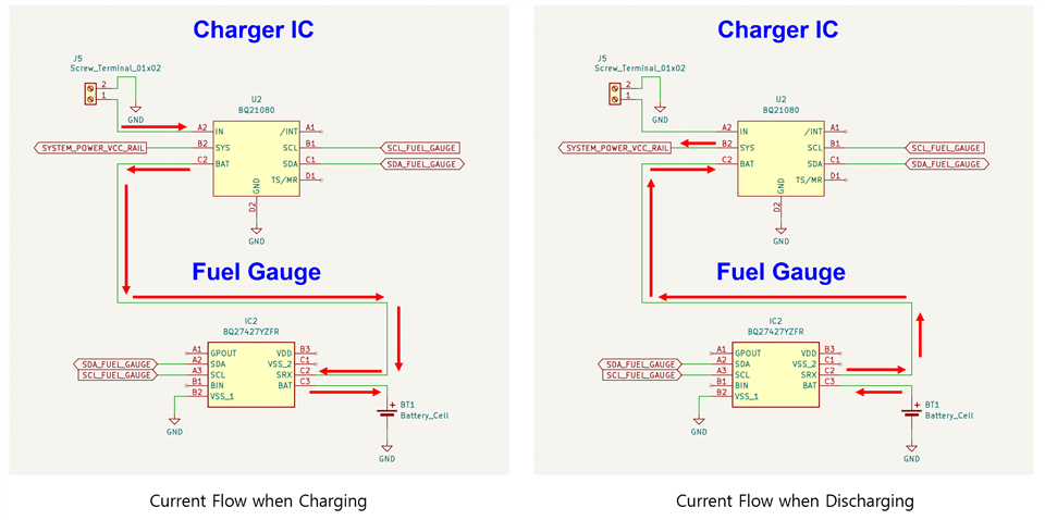

In my project, I considering BQ21080 (=charger IC) and BQ27427 (=fuel gauge).

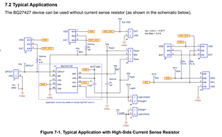

Is this right wiring? For fuel-gauge to monitor the current flow in both charging/discharging phase, I think those two ic should be wired up like below.

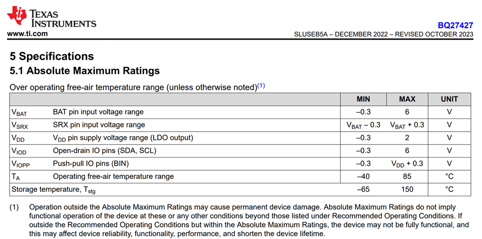

However, when you see the BQ27427's datasheet, SRX input voltage can't be over "Vbat +/- 0.3V" which doesn't make sense considering lion charger's multiple phase of charging.
If am wrong, what part I am wrong?
