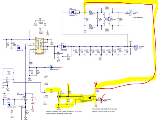

  • Hi Hemal,
    Thanks for reaching out.
    You can considering using TPS23731's reference circuit (PMP22806) + PMP22477’s secondary oring circuit (PMP22477). It will lower the PoE output voltage when 12-V adapter is added. Please see the heighted circuit in below.

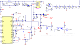

  • Hii Diang,
    Thanks for the reply.
    Point 1: This additional connection which you shown here to give adapter priority is for TPS23730RMT but can you please provide full ref. circuit with this adapter priority connection for TPS23731.
    Point 2: Here you mentioned that below circuit will lower the POE when adapter voltage added but how much lower? Provide value of that lower voltage?
    Point 3: Can you explain how this logic work means if we lower POE then how it give adapter as priority? please explain scenario.
    Point 4: And if we consider this below logic for adapter priority then please confirm Device [TPS23731] not going to reboot for below two switching case.
    Case 1:- if a device is running on POE Supply and in this condition 12V Adapter DC supply entered then according to DC Supply as a priority, supply need to switch power from POE  to DC Adapter.
    Case 2:- And now further by taking this scenario continue suppose DC Adapter Power supply removed [POE supply still plugged in] then device supply again get back to POE as input source.

  • Hi Hemal,
    Thanks for your patience. Please see my comments below:
    • Sorry we do not have a TPS23731 design with such circuit. But the adapter structure is the same. And PMP22477 is also a flyback converter.
    • The FB voltage is 1.75 V. And the AUX winding voltage to SEC voltage is 1:1 at rectifier on time, which makes the desired AUX voltage = 12 V at rectifier on. Approximately, when Q5 is off, Vout = 1.75V / (4.99k || 35.7k) x (4.99k || 35.7k + 24.9k) = 11.7 V; when Q5 is on, Vout = 1.75V / (4.99k) x (4.99k+ 24.9k) = 10.5 V. You can change Q5 on/off by the opto.
    • When J14 is short. Q5 is off; when J14 is open, Q5 is on.

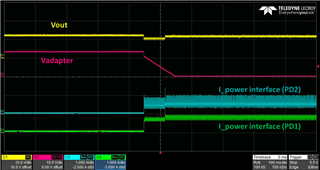

    • Yes, it won’t reboot if the load can work at 10.5-V and 12-V. In a short term the Vout may drop as the below example.
    Point 5: For above both case can you please how much time it take to switch power from POE to DC and DC to POE individual case?
    • You can see the below example waveforms. It is not PMP22477 but with similar secondary side adapter circuit.
    PoE->Adapter Transient (dual-PD, hitless):
    Adapter->PoE Transient (dual-PD, hitless):
