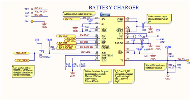

Hi Team,
We are using bq25120A in one of our projects.
See the circuits below:
We are getting the TS fault error, ie, on 02h, we are getting e8 and a8 in normal working temperature(25deg.c).
We tried disabling TS functionality by putting R5=6k and R19=12k and R20 as DNM.Still we are getting error.
When the issue occur the TS voltage is observed as less than 0.9V or grater than 1.8V
Can you please suggest what could go wrong here.

  • Hi Jenitt,
    It appears that the TS voltage detected is above or below the TS warm and TS cool voltage thresholds, though this is being read at 25C. Can you confirm your NTC's properties (Beta value and calibrated resistance) so that I can calculate the expected behavior across temperature?
    If you force a voltage on TS you shouldn't see any TS fault between 20.8% of VIN and 35.4% of VIN. Can you confirm this is the case on your charger?

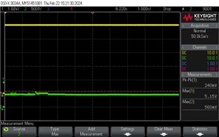

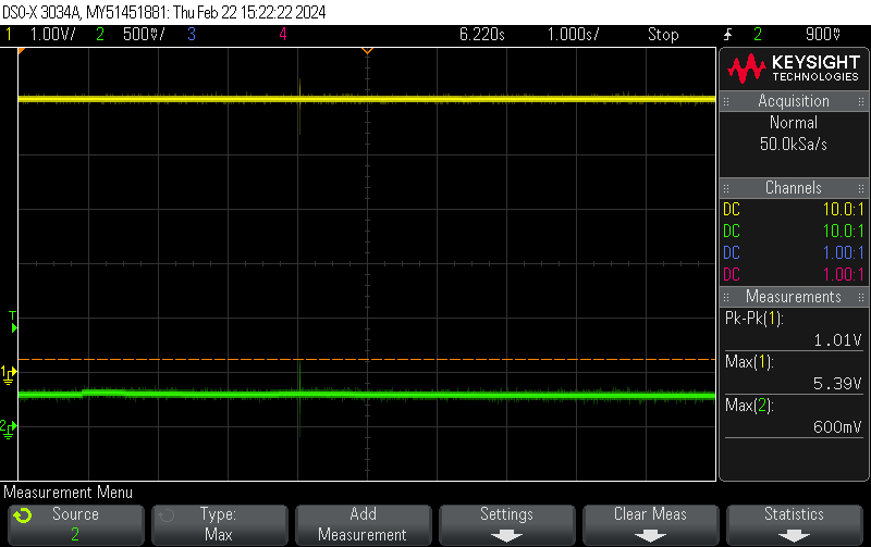

  • Hi Juan,
    Thanks for your reply,
    Please find attached waveforms-
    Green- VTS PIN(500mV/Div)
    Yellow- 5v VIN(1V/Div)
    Our Vin is regulated and it is stable at 5V and resistor(Rhi=24.9k and Rlow=40.2K with NTC 10K) we also checked the resistor values and We removed thermistor mounted Fixed 10K, The Behavior is same.
    We notice VTS Drop from 1.26V to 300mV after keeping the device on and in charging state for 15 mins
    We suspect something is going wrong on BQ25120A TS.
    Kindly Let us know your inputs and suggestions.
    Muhafeez

  • Hi Mahesh,
    Apologies for the delay. The VTS behavior is certainly unexpected since voltage at TS should be purely determined by your VIN and the resistors used across the resistor divider. The BQ25120A should not be exerting any kind of voltage or current on the TS pin, only sampling the voltage. This is especially unexpected with a fixed resistor since voltage should never really change. If there are no other paths to this node via which this it can be biased, and if there isn't a possible soldering or contact issue then I would suspect the device may be damaged.

    1. What is the current consumption of BQ25120A TS pin?
    2. With divider network resistors of 24.9K and 40.2K, the current allowed flow is =5V/65.1K =77uA only. Is this okay for TS pin functionality?
    Sudheer
  • Hi Sudheer,
    The current consumption of the TS pin should be minimal since inside are only comparator input circuitry. I will have to look for an exact number.
    This current flow should be fine, the TS function at this device cares mostly about the voltage so it s a high impedance input and does not require a lot of current to function.
