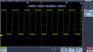

First scenario:
Occasionally, one 24V switcher circuit is not stable and shows a saw tooth output instead of flat 24V.
Question 1: If this is applied over a longer period, can this condition destroy the LM5088?
Question 2: What causes the output voltage to oscillate like this (saw tooth)?

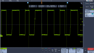

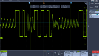

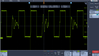

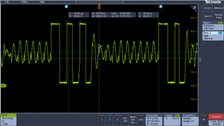

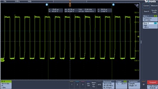

Second scenario:
Different load scenarios from low load (open clamps) to approx. 4A in 0.5A steps (see blue: Current probe, showing load current) are shown.
My understanding is that the oscillation seen in three of these pictures are results of instabilities in the feedback loop.
Picture 1,2 & 4
Is that correct?
