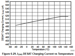

    In your reply, you mentioned that the "detection threshold" and "capacitor charge current" values can vary from component to component. Of course, I understand that identical components from the same model may not be exactly identical in every aspect in real-world designs, such as slight variations in output resistance. However, we usually ignore such negligible variations for practical purposes.
    However, if the variation in values shown in the figure represents the minimum and maximum values for component-to-component, wouldn't this imply that we need to perform desaturation tests repeatedly for each produced unit?
    I am asking the question, but most likely, I will calculate based on typical values and make adjustments according to its practical response. However, I am concerned about the variability in values in repeated productions. I want to know the main reason for these variations in the "detection threshold" and the "capacitor charge current" values. For example, if it is ambient temperature, and if it is possible I also want to know which direction the values will change as the temperature increases.

  • Hi Harun,
    In our datasheets we include graphs across temperature for critical parameters for you to be able to see the trend across temperature. For UCC21750 it is section 6.12 Typical Characteristics.
    In this section of the UCC21750 datasheet you can find the graph of the DESAT threshold vs temperature (Figure 6-24) and charging current (Figure 6-29). These graphs use the mean of each parameter at each temperature (-40C, 25C, 125C, and 150C) to show the typical characteristics across temperature.
    Both DESAT threshold and charging current approach the move towards the max values with increase in temperature.
