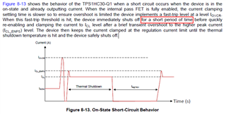

What's the responding time of over current?(The time from short happens to the chip shut off the output)
In the datasheet, just say for a short period of time.

Song,
The fast response in the case of a large pulse (OVCR) is on the order of 1us to 1.5us. The current limit deglitch time to assert is typically 2.5us.
