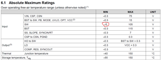

Hi:
   Confirm that the negative voltage of SW of LM5122 is -5V
   However, the waveform tested from Spec. is -10V (as shown below)
   -10V is out of spec., Is there any problem?
  • Hi Tom,
    Thanks for reaching out. I suspect this was caused by measuring with a long oscilloscope probe, which would cause a measurement error with such a high frequency.
    Notice that in figure 44 of the datasheet, the switch node is not falling below -5V.
    Thank you and best regards,
    Bryan
