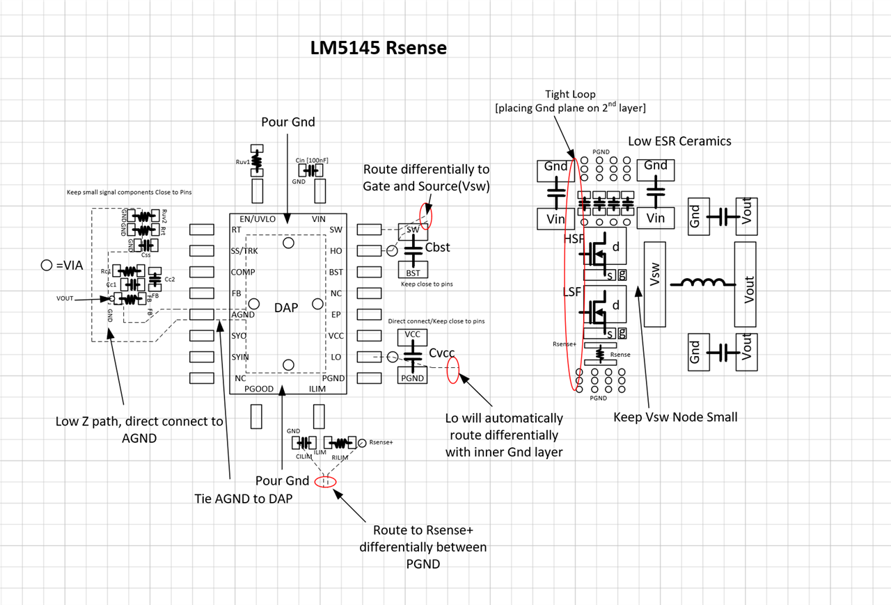

  • good morning,
    Thank you for your prompt response, sir. in this reply I am attaching my calculations excel and schematic file for better understanding on my problem.

  • Hello Venu,
    I checked your design, I don't see anything that stands out to me that would case failure.  How is your layout?
    Did you follow the guidance provided in the datasheet, if not, this may  be the cause of the failure.  Also do check you have installed the correct values and there are no shorts on your board.
    Layout concept based on datasheet guidlines.

  • Hello Venu,
    If the layout is poor and guidelines not followed, this can cause failure to the device.  instability can cause a device to fail in addition to noise causing the device to malfunction, turning on a FET when it is supposed to be off during the period is one example.  Hope this helps.
