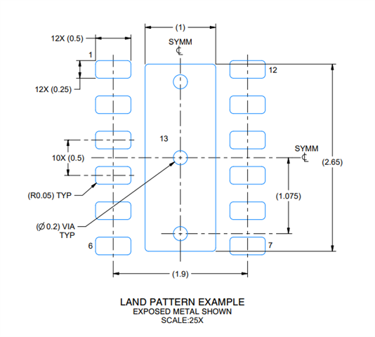

The package outline of the LM5155 shows that it is package DSS0021B (WSON).
It can be seen that in the worst case calculation the distance pad to thermal pad = 1/2 * (1.9 - 1.1 - 2*0.35) = 0.05mm.
How can this be?
How can this be?

Hi Aferdita,
Sorry for the long delay on this.
I am not sure if I fully understood the question.
The last section of the datasheet describes measurements and sizing of the WSON package.
Did you find any error within these specs or is the question referring to something else?
Thank you very much for clarifying.
Niklas
No i didnt find any error's i was just wondering if the minimal distance pad to thermal pad really equals 1/2 * (1.9 - 1.1 - 2*0.35) = 0.05mm.
If this is the case i am unable to use this Chip due to the design clerance of 0.15mm.
