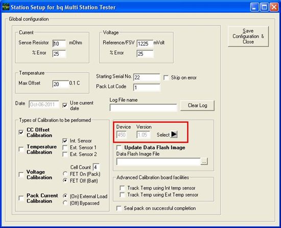

    I spent some time messing with MTester this afternoon and I was finally able to get it working for z45 R1. The first snag I ran into was the Config.ini file. It should actually be like this:
    [D450]
    Platform=32832
    CalWr=60
    DateOffset=12
    PkLotValid=0
    ITOff_DFOff=18
    ET1Off_DFOff=19
    ET2Off_DFOff=20
    The platform was incorrect. To make it easier, I have attached the Targets and Config.ini files you need so you can just copy them to the Texas Instruments\bq Tester folder.
    The second issue was in the following screen in the bq Tester StationSetup:
    I wasn’t selecting the Device and Version.
    ·         To fix the issue you describedabove “Single site InitCacheFromSetup() failed for board 1.Error code=65557you’ll need to uninstall and reinstall the Mtester software. I don’t know what the error code is, but I never saw it in my installation or board setup.
    ·         Make sure to run the bq Tester StationSetup software first to set up the device version, calibration routine, and other pack specific data. Then run the bq Multistation Tester. I have attached a document from our Deep Dive last year that may help. It was written for the z90, but the general procedure should be the same.

    It now appears we can use bqMTester to  EITHER do a calibration OR update the flash from a .rom file.
    If we select in the StationSetup program to do calibrations and update the flash together within bqMTester, then we get an Error code = 65570 and in the lower window a Pass/Fail Error code 65544.
