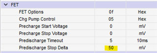

I'm using BQStudio Test build 1.3.124.
I want to export a Data Memory configuration for later. However I have noticed that when I re-import the config file I just exported one of the values has changed.
GUI before export:
Export to file then import the file. The GUI then looks like this:
But if I now export again, the value does not change to 5000 (another factor of 10) but remains as 500.
The TRM suggests that this value's underlying units are actually in multiples of 10mV and the default value is 50, giving 500mV (I assume).
But which units does the BQ Studio GUI show? The Precharge Timeout setting directly above shows units of 10ms, not ms. How do I tell which units I'm supposed to enter the value in and how can I have confidence that when I export to file the values won't be changed?
