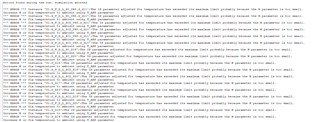

    1) When simulating the TPS92610-Q1 spice model above +30°C the below mentioned error was observed:
    Error obtained:
    *** ERROR *** Instance 'U1.X_F_D_L_SC_U48.d_d11':The IS parameter adjusted for temperature has exceeded its maximum limit probably because the N parameter is too small.
    Increase N or fix temperature to ambient using T_ABS parameter
    *** ERROR *** Instance 'U1.X_F_D_L_SC_U48.d_d10':The IS parameter adjusted for temperature has exceeded its maximum limit probably because the N parameter is too small.
    *** ERROR *** Instance 'U1.X_F_D_L_SC2_U48.d_d11':The IS parameter adjusted for temperature has exceeded its maximum limit probably because the N parameter is too small.
    *** ERROR *** Instance 'U1.X_F_D_L_SC2_U48.d_d10':The IS parameter adjusted for temperature has exceeded its maximum limit probably because the N parameter is too small.
    *** ERROR *** Instance 'U1.X_F_D_L_SC1_U48.d_d11':The IS parameter adjusted for temperature has exceeded its maximum limit probably because the N parameter is too small.
    *** ERROR *** Instance 'U1.D_D14':The IS parameter adjusted for temperature has exceeded its maximum limit probably because the N parameter is too small.

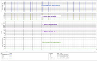

  • Hello Hailee,
    1) I understand that the provided spice model in the TI website for TPS92610 is the latest one. (But this spice model i supporting only in the mentioned temperature range (-10°C to +25°C)
    2) We have a OFAF scenario in which if one LED is disabled another LED also to be disabled by connecting the FAULT lines of the 2 TPS IC's.
    (Note: LED current of 2 TPS are different)
    when doing this OFAF analysis, we could observe the spikes in LED current for some short times repeatedly. Is there any method to disable the Power on reset in the TPS92610 IC. please confirm
    Mohammed Khalif

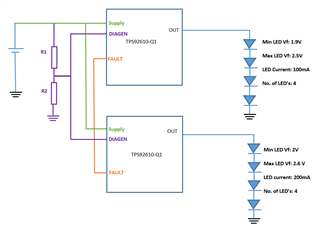

  • I have attached the schematics model below:
    Along with the above connections, the PWM is externally pulled up with 10K resistor and the SSH a& SSL  is connected with voltage divider.
    In the above schematics, when the LED from the 1st TPS IC is open then the other LED connected in 2nd TPS IC is generating below graph result. Instead of continuos low signal (0mA or less) repeated current spikes appeared with short intervals (Blue color)
    Thanks and Regards,
    Mohammed Khalif

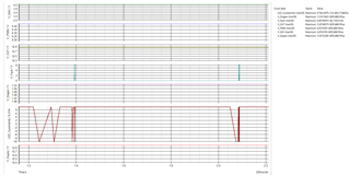

  • Hello Hailee,
    1) I have attached the waveform results in the below image:
    2) Please check the above image.

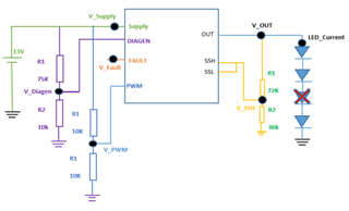

    3) I have added the resistor values and SSL connections in the below image:
    The supply voltage range is 9-16V. In the specified voltage range if 1st IC LED is open then the 2nd IC LED current obtained with spikes in short interval. (please check above graph result).
    Thanks and Regards,
    Mohammed Khalif
  • Hi Mohammed,
    • Could you share the detailed schematic? From the schematic model, the information is limited, especially about the external components and circuit connection - For example, I can see the SUPPLY pins of IC1 and IC2 are connected together, but from the waveforms, Vsupply of IC1 and IC2 are different? are IC1 and IC2 on the same PCB board or different board?
    • Where is your output current measurement point for IC1? where do you create this open fault? and how do you test the FAULT current?
    • From the waveform it appears that FAULT signal is abnormal, causing the IC2 to be constantly released. Please zoom in the current spike and the corresponding waveforms, and check if IC1 is in a fault state by coincident the voltage of the Vin with the voltage of the Vout. - the typical V(OPEN_th_rising) = 100mV.
    The Mechanism of open fault detection is shown below.
    • Would it be possible for you to disconnect the FAULT signals of two ICs, and do the same test on the IC1?
    BR,
    Hailee.

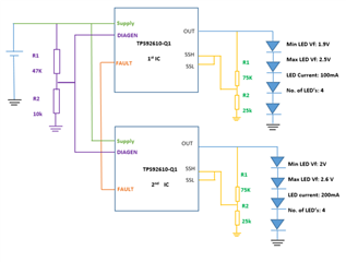

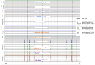

  • Hello Hailee,
    In the below schematic reference, I have checked the fault signal (high/low) using 1 TPS92610-Q1 IC during OFAF condition:
    Also, I have captured the probe results below:
    During OFAF condition, the fault signal is not setting to low consistently. Please check the above waveform result attached.
    Note: Please click on the image for the expanded view.
    Mohammed Khalif
  • Hi Mohammed,
    Please also zoom in the Vout - like Vsupply, and zoom in only 1 or 2 cycle in time - like ms/div.
    BR,
    Hailee.

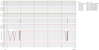

  • Hello Hailee,
    The requested waveform is attached below, please check and provide a solution/comment for making the fault signal low during OFAF condition:
    Mohammed Khalif
  • Hi Mohammed,
    It is weird that the Fault signal is constantly being toggled and the LED current varies from 10mA to -10mA.
    • Could you share the full schematic with external components and the PCB file? especially for the Fault pin and OUT pin. Also please indicate the test point of the LED current and Fault voltage.
    • In your application, there are 2 ICs in this system, have you tried the same test on the IC2? what is the test result?
    BR,
    Hailee.

  • Hi Mohammed,
    Sure, as you can see from the datasheet, when the IC detects a fault condition, it will pull the FAULT pin LOW as shown in the picture (from a real board).
    The device can work normally and there is no special issue. Please refer to the Figure 18 and 19.
    OFAF is a function that can be performed on multiple devices connected on the same fault bus.
    BR,
    Hailee.
