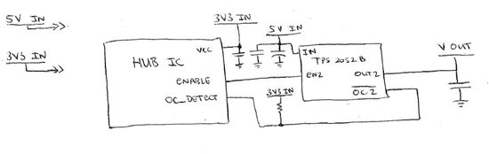

    Please provide detailed O-scope waveforms showing the details of the event (IN, ENb, OUT, and OCb and IN current if possible), and also the schematic including all pertinent surrounding circuitry.

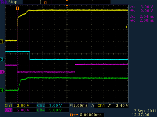

    Please see the capture below, with the traces as follows: 1) IN (5V supply), 2) Current into the "IN supply" of the PCB, 3) Overcurrent Sense 2 (Active Low), 4) Out 2.

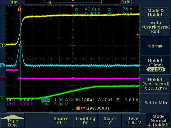

    And the following capture where trace 2 is no longer the current, but is the Enable 2 signal (active high):
    Although I cannot provide the complete schematic, I have attached the following sketch to help show the circuitry.
    When capturing these plots, I have removed any downstream devices and loads, I have also removed any downstream bulk capacitance. The current captured in the first plot is not the current into the device, but is the current for the 5V supply into the board, and hence it represents a few additional loads (mostly capacitive) as well as the TPS2052B and downstream.
    Things of note in the screen captures, especially the top one:
    The /OCx output trips before the inrush is very high, despite the inrush only occuring for a very short period of time.
    The /OCx output trips before the output voltage begins to increase, and the output voltage continues to increase for a period of time despite the overcurrent tripping.
    After ~2ms, the HUB IC disables the enable input of the TPS2052B, and the downstream output voltage begins to fall.
    Neal Wilding
