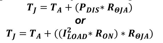

    For the thermals- it will depend on many factors such as layout and ambient temperature. You can estimate the temperature rise using the following formula:

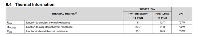

    In general, at higher temperatures RON will be higher which would lead to a sharper temperature rise. From the datasheet, Rtheta:
    and the RON:
    This assumes a standard JEDEC 2s2p layout... so for 2A at 25C ambient it would translate to approximately a junction temperature of 52C
