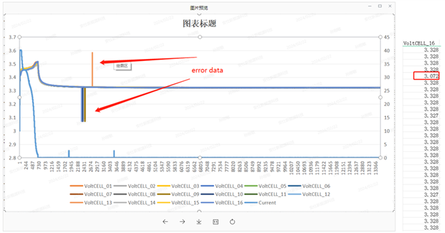

1, When reading current and voltage, the read data is abnormal .
The following is the collected cell voltage:
3328mV = 0x0D00
3072mV= 0x0C00
It is speculated that when the voltage changes from 0x0D00 to 0x0CFF, when the MCU reads the low byte (0x00), the high byte data changes from 0x0D to 0x0C, causing the data read by the MCU to be 0x0C00, which is different from the actual value 0x0CFF. How to solve this problem?

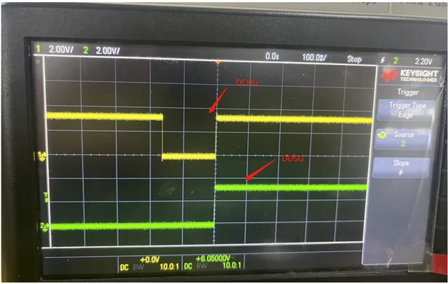

2, When using DCHG and DDSG to control the MOS, when DDSG is turned on, DCHG will be disconnected (the FET_CONTROL subcommand (0x0097) is used). Is there any solution to this problem?
As shown in the figure below, when DCHG is turned on, turning on DDSG will cause DCHG to turn off
Please help check it.

    1. Is the customer making sure that they are waiting long enough for the device to load the cell voltage data into the transfer buffer? If they try to read the data too fast they might get bad data out, similar to what they are seeing.
    2. Do you have the customer's settings and what they are sending with the FET Control subcommand?
    Max Verboncoeur
  • Hello Star,
    Are they using block reads to read the cell voltages? Using block reads should avoid having issues if the cause is due to reading the different bytes of cell voltages at different times.

    DCHG and DDSG can be controlled through FETControl (Subcommand 0x0097). The problem is that when one of them is closed (such as DCHG is closed), closing the other (such as DDSG) will cause the control pin that is already closed to be briefly disconnected.
    2, FET Control command content:
    Read the FET Status() (cmd:0x7F) status as 0x61 (DDCHGbit = 1). At this time, write the value 0x00 (CHG_OFFbit = 0, DSG_OFF = 0) to FET_CONTROL() (subCMD:0x0097). Normally DDSG should be closed and DCHG status should remain unchanged.
    After writing, DCHG is first turned off for about 100ms (waveform diagram posted above), and then DCHG and DDSG are turned on together.
    Star
  • Hello Star,
    As I said, they should not be using the FET_CONTROL commands with the digital pins DDSG/DCHG.
    If they want to control the FET's turn-off, they should use the CFETOFF and DFETOFF pins instead.
