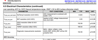

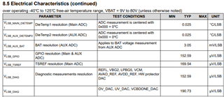

please confirm that the datasheet SLUSE81C is wrong in stating that:
- V_LSB_DIAG = 152.59 uV/LSB shall be used for "all the HW protector DAC"
on page 15.
I only get correct readings when I use the VCELL resolution (190.73) for the voltage protector DACs (OV_DAC, UV_DAC and VCBDONE_DAC).
For the temperature ones, it does not matter since LSB for DIAG and GPIO are the same.
