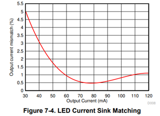

Is the LED current sink matching characteristic (Fig 7-4) same for both boost and sepic configuration?
It is not written which configuration on the datasheet.

Hi Kei,
Yes, the current sink performance is not impacted by topology.
