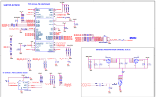

TPS65988: Not getting input power simpultaneously form both the input of TPS65988DHRSHR
Part Number: TPS65988
Hello Ti.
I'm using TPS65988DHRSHR with inputs at VBUS1 and VBUS2, while type C connected at VBUS2 it is accepting power but if I connect VBUS1 it is not accepting power ( I input = 0A), find the attached schematic,
I like to use it in default mode (i.e. without flashing or using SPI and SPI EEPROM)
Changes Done: R283: 100K, R282: 25K
