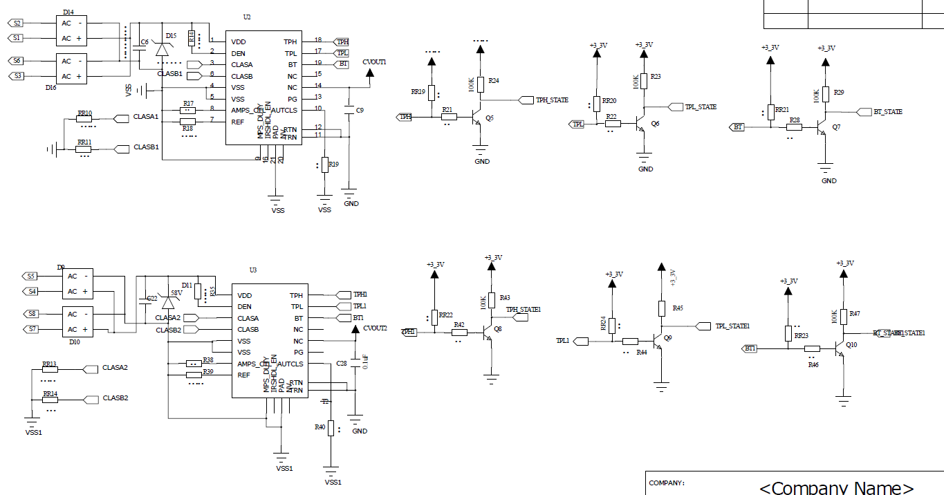

Hi Ti experts,
We are using TPS3272-4RGWR to monitor the POE output.
We don't need power output and just need TPH/TPL/BT three output pins to monitor the statues of front POE.
Issue:Some boards are have no output from TPH/TPL/BT three pins. After changed chip to new one, new chip works well but after some time later, new one will also has function failure.
Could you please help check the schematic as below:

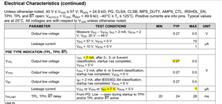

    TPH/TPL/BT pins are open-drain. When function fails, can you check the pin voltage on the chip side? Want to know if it is the BJT/3.3V failure or the TPS2372 pin failure.
    The NC pin should be leaved open. Does CVOUT connect to any nodes?
    And could you let me know the resistance of the cycled resistors?
    Diang
  • Hi Diang,
    Cvout1 don't connect with anything.
    R42 is 1kΩ.
    R22 is 1MΩ.
    We will test 3.3V/BJT later.
  • Hi Gary,
    Thanks for your reply, please test the voltage one the pin directly.
    I am wondering if 1M is too large for 3.3V bus voltage. Though the on resistance of TP pins is ~0.27V/2mA = 135 Ohm, and off resistance is 7V/1uA = 7MOhm. Is the 3.3V/1M=3.3uA current able to drive the BJT?

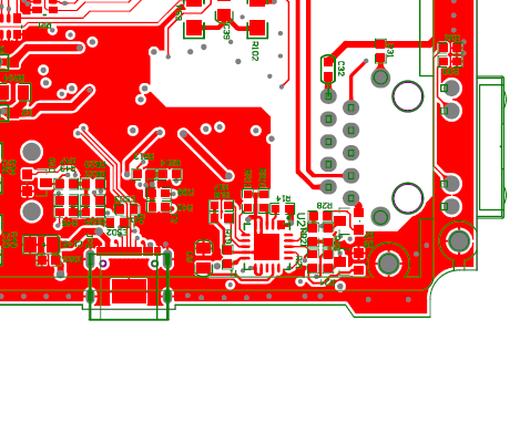

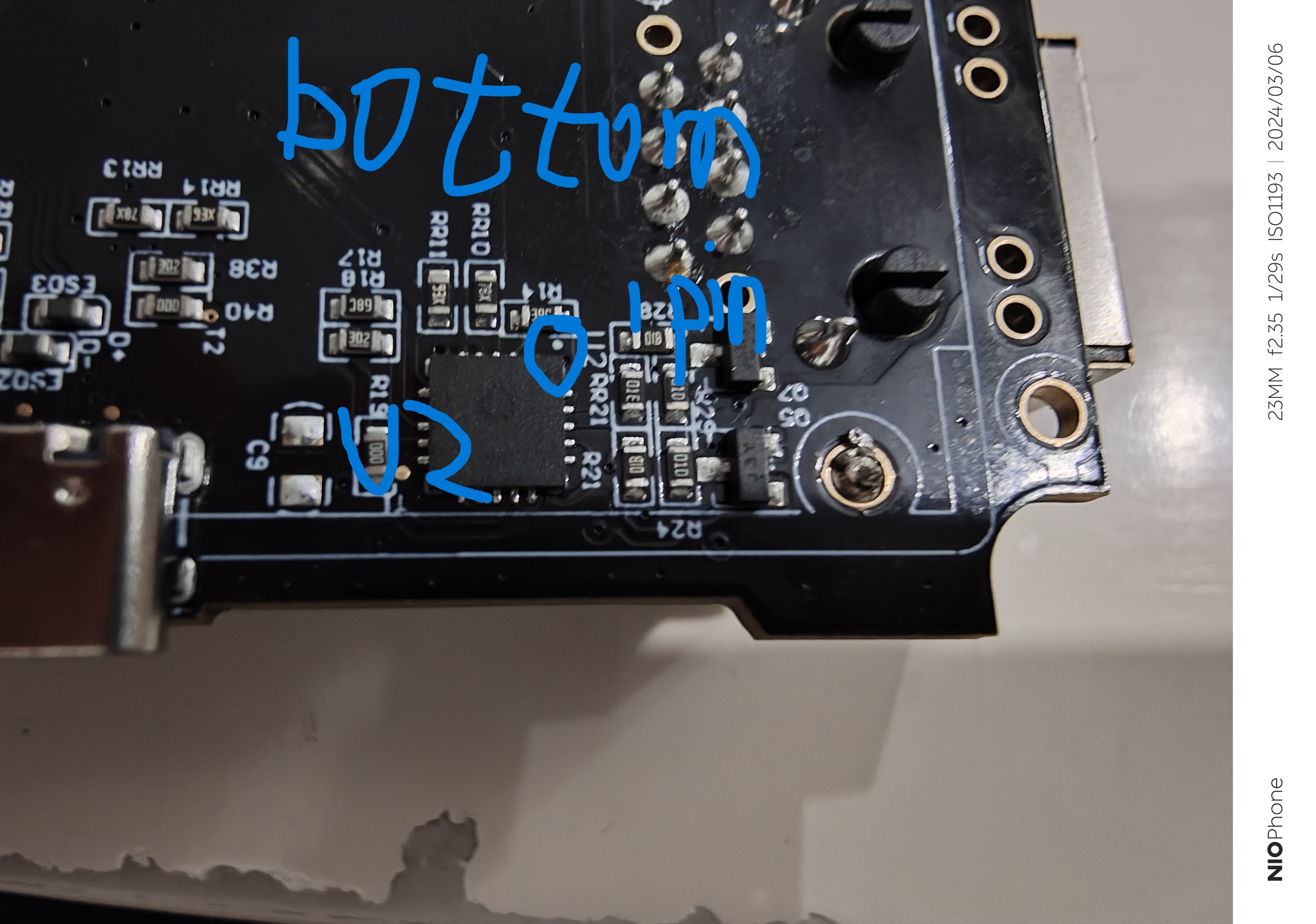

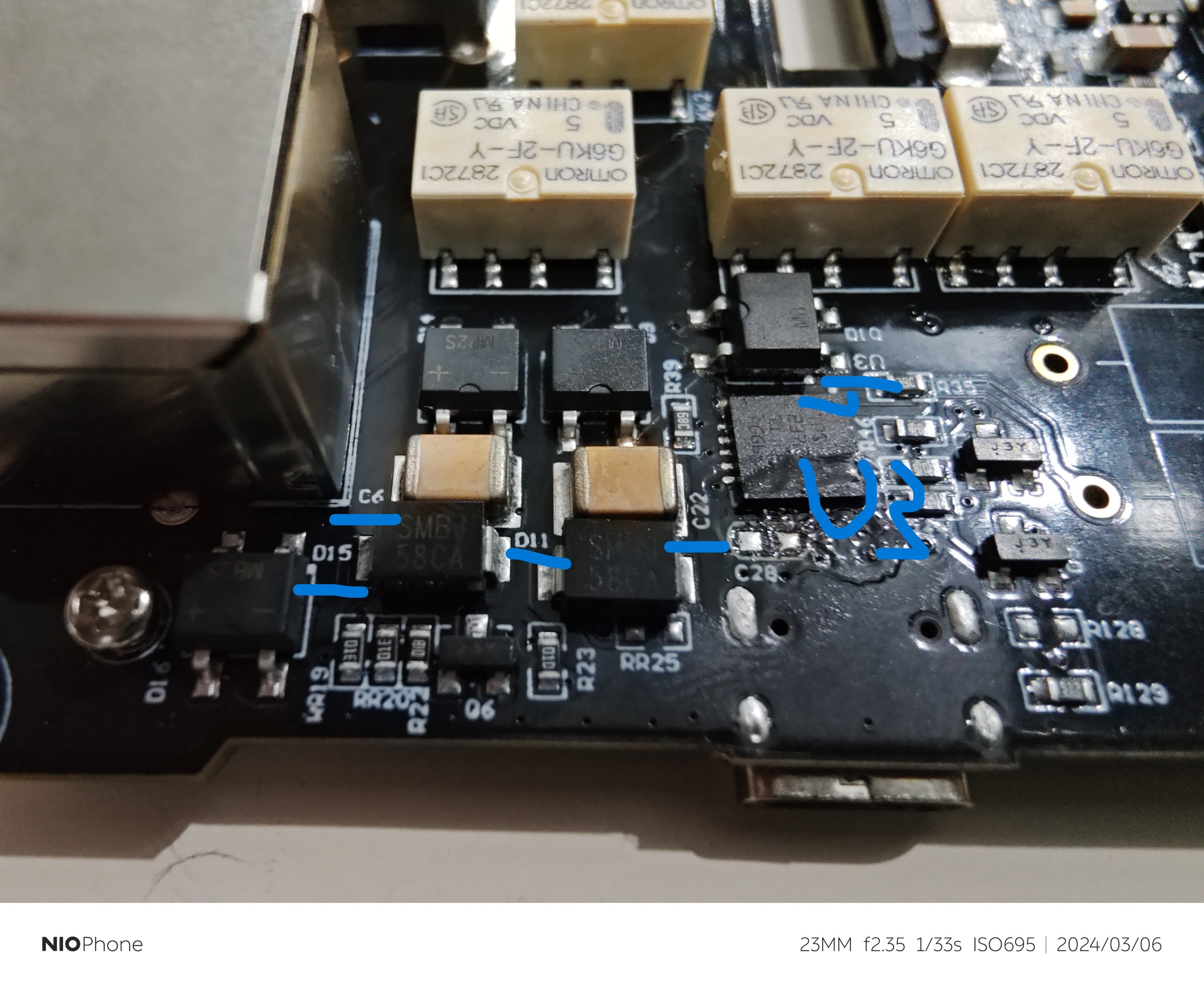

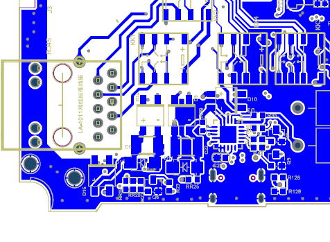

    We use two of TPS2372(U2 & U3) to detect the power on the same Internet BUS. U2 is for the front 2x pairs and U3 is for anther 2x pairs.
    We found that all the damage TPS2372 are U3.U3 is on the top layer of PCB and far away from D11 and C22.
    U2 is on the bottom layer of PCB and its D15 and C6 are on the top layer and closed with U2_pin1.
    What do you think about the layout. is it the IC damage reason that D11 and C22 are far away from U2?

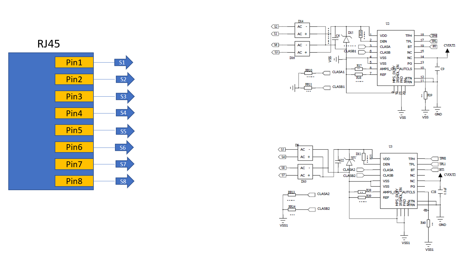

  • Hi Diang,
    My customer indeed use 2x TPS2372 in this project and I think one of it is enough but customer has already finished the product. This product is used for measuring the functionality of POE and PD instead of powering devices through network cables.
    Two of TPS2372 don't use same VDD but use the same RTN. U2 connects with first pair and third pair and U3 connects with second pair and fourth pair as below:
