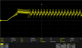

Here are some plots of the output, it averages about 1.5V:

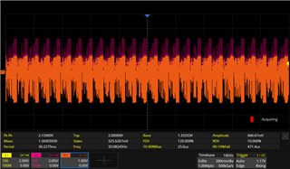

Here is the voltage across the inductor (C1 and C2 are voltages either side, with the orange plot being C1-C2):

    Thank you for your quick response. It can be because of high capacitances also. That is why I want to have a look at inductor current because that will help me to understand  what is happening with the device. HICCUP is normally triggered by OCP and increased capacitance can trigger the OCP. During startup, higher current will be needed to charge this higher output caps when output voltage rises (According I=C*dv/dt)
    Also because of the noise I can completely understand the cycle.Is the first measurement of Vout the start up behavior?

  • Thanks Farheen. Yes, the first plot shows the Vout as the soft start picks up and begins the hiccuping behaviour. And the 2nd plot shows (in orange) the voltage across the inductor terminals. The DC resistance is 29mOhm. I will see if I can get a slower plot today if it helps.
    Noting the capacitance potential issue, I tried slowing down the SS startup time considerably (from <1ms to 200ms), maybe I'll try to increase this more. I thought this would allow for charging of the caps and avoid OCP.
    At this point I don't know if it is noise or capacitance causing the hiccup. The noise (which looks like switching noise to me) is emitted by the  TPS62813, which makes me think it needs more capacitance? The first plot above shows the solid yellow line which is pulsed DC, and the "fluff" above and below it is what I think is switching noise. You can see it increase as the voltage increases. I don't think there is a great deal of capacitance on the Vout (1.8V) rail, it must be only a few hundred uF and as for PCB plane capacitance, it's not a plane, more just small patches and traces.
