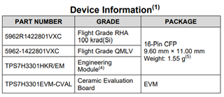

Is 5962-1422801VXC tested under radiation environment?
If not, could you let me know the test or screening difference between 5962-1422801VXC and 5962R1422801VXC?

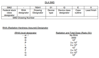

Hi David,
5962-1422801VXC is not Radiation Hardness Assured. This is indicated by the "-" in the part number.
5962R1422801VXC is rated for 100krad(Si) TID radiation. This is indicated by the "R" in the part number.
Please see this PDF for a full description of the other designators within the part number.
We also describe the radiation rating of each device on the front page of the datasheet for convenience.
