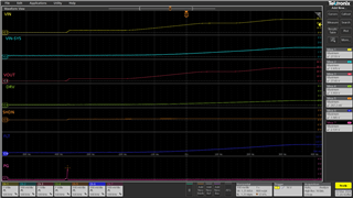

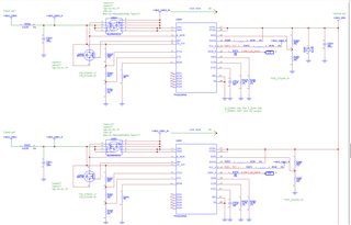

We designed an ORing circuit which have 2 inputs and 2 TPS26630RGE (+ external blocking FET) performing as ideal diode.
There is a case that only one of the inputs has power source but another doesn't, in this case, expecting the TPS2663 can block any leakage to input 2, however we saw an issue.

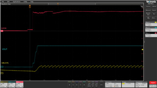

For example, if input 1 provide a 28V power, we can see 28V from the output of another TPS2663 as well, in this test case, we saw the input level of another TPS2663 was raised due to IN_SYS pin has a 19V power leakage even we have an external block FET.
Can you help check if this behavior is as expect?
