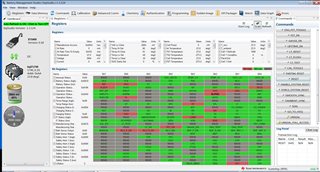

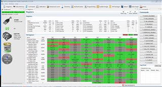

  • Hello Nick,
    Here are the screenshots of the registers.
    After sending the shutdown command:
    After resetting:
    The XCHG and XDSG flags were still being set after the shutdown command.
    Do you see other potential problems of why the XCHG and XDSG being set?

  • Hey Eric,
    Thank you for the screenshots. However, I want to review a log file so I can watch every registers change over the duration of the test. This will allow me to  have a better understanding on what's causing the XCHG and XDSG bits to set. You can get a log file by pressing the "Start Log" button on BQStudio.
